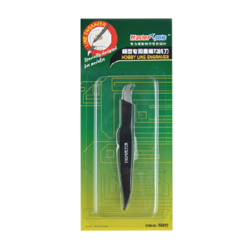

Thanks mate. I've got sooooo much time scribing invested in this ATM it ain't funny but I'm not scared to admit defeat :shock: :shock: :shock: This is what I'm using for most of the scribing. Like I said consistency is my issue. Some of my lines look like Mr Tamiya himself did them, and then most of the others look like an epileptic earth worm that has had way too much meth has had a crack at it :lol: :lol: :lol:

Do you use anything as a guide for scriber tool? I use vinyl precision masking tapehttps://spsupplies.co.uk/product/3m-vinyl-tape-471-indigo-6-mm-x-32-m-0-14-mm-06405/. I find it perfect for straight lines and it's also flexible to make curved lines too. I just tape it down where I want the line and gently lean into the edge of it. Before I discovered this tape, I was taping two or three layers of masking tape onto cuting mat and cuting out strips to use as a guide. Hope this helps.

I use a small steel rule, scribing templates and Dymo tape like this

I tried dymo tape, but didn't like it that much. Another thing I really like for scribing are Tamiya micro saws, 0,15 thick.
They are specialy good for scribing on diferent materials. Whatever you chose, good luck! I usualy need that too.
