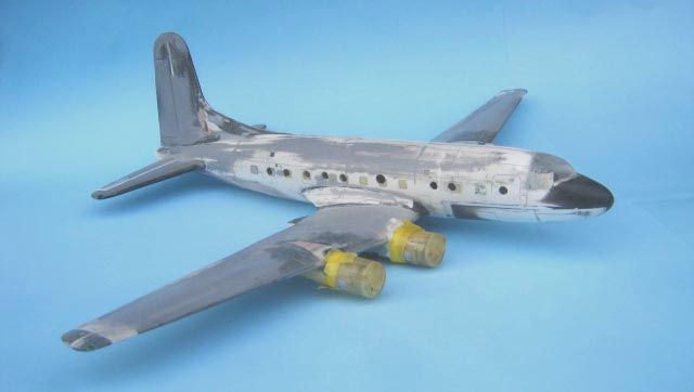

Postby frediv » Sun Nov 01, 2015 6:53 pm
Image[/URL]
Fuselage: Heller DC-6 suitably modified. Apart from shortening, black areas and lines give an indication where these modifications have been done.
Wings: Inboard section to dihedral break, Airfix Lancaster plus bottom outer section. Remainder, Heller DC-6. Rather surprisingly, these sections matched up perfectly, both in plan and aerofoil section, and required no filling or trimming. The most difficult area was removing any trace of the DC-6 nacelle above the wing.
Fin/rudder: 90 mm of Lancaster outer wing with tapered insert to increase the tip chord.
Tailplane: Airfix B-29 tailplane with tapered insert to increase the root chord.
Engines: Lincoln items of unknown origin but extensively modified to suit the Tudor.

Postby hrtpaul » Sun Nov 01, 2015 7:22 pm
Holy crap mate that's insane. Love it :)

Postby Graeme H » Mon Nov 02, 2015 7:21 am
Lovely work there Fred, nice combo of kits to get the result you have

Postby kfutter » Mon Nov 02, 2015 7:23 am
Awesome stuff, Fred! Looking forward to seeing the end result.

Postby Adam the Akrodude » Mon Nov 02, 2015 9:13 am
Incredible Fred - I salute a true modeller!
Where did all the bits come from to build this "Franken-Tudor"? You must have a decent scrap box!

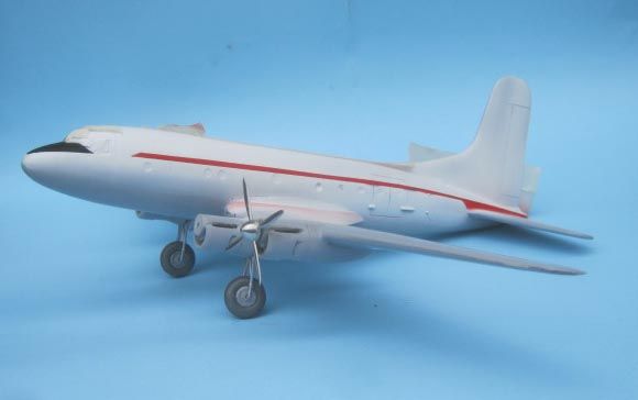

Postby frediv » Sun Dec 06, 2015 6:23 pm
Image[/URL]
Some progress. On its wheels, temporarily, and first colours of AIR CHARTER livery applied.

Postby hrtpaul » Mon Dec 07, 2015 10:02 am
Amazing Fred. That looks bloody awesome :)

Postby Adam the Akrodude » Mon Dec 07, 2015 10:21 am
Brilliant work there Fred!
