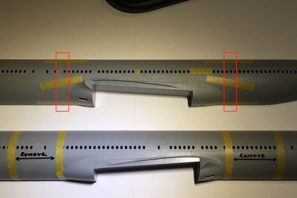

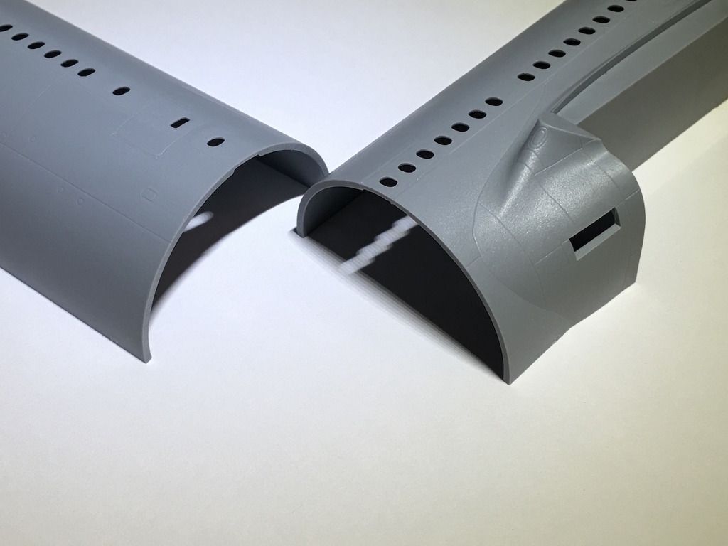

The left fuselage part has been cut to the correct size, I removed 10 windows in front and 9 windows behind the wing :
The red rectangles represent the cut lines but they are barely visible due to bad lighting :

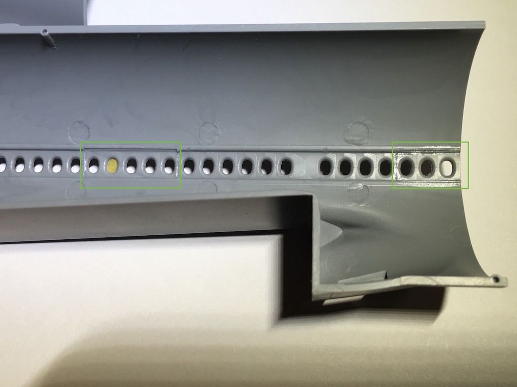

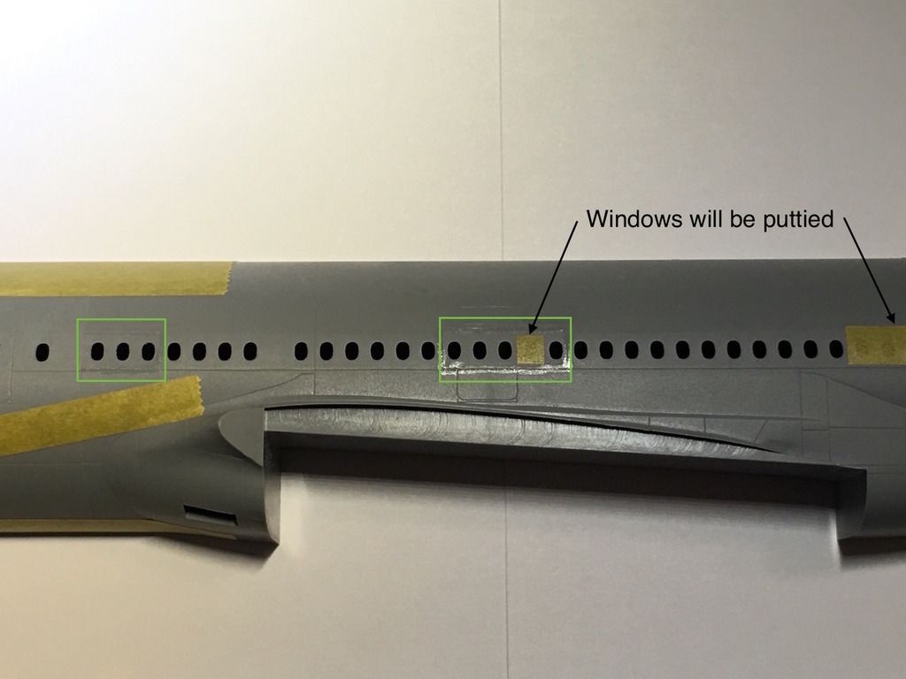

The green rectangles represent the window patches I had to do to restore the window count which is different from that of the 777-300ER. The 5 windows to be puttied, on the right side, are where the door 3L is located :
Sections ready to be glued :

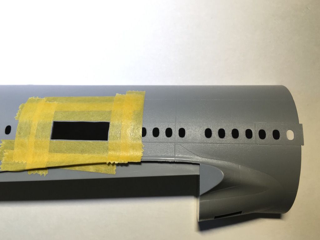

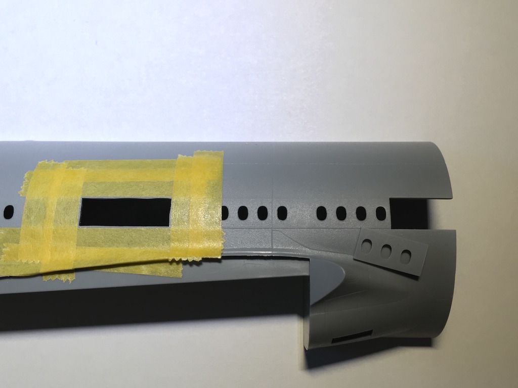

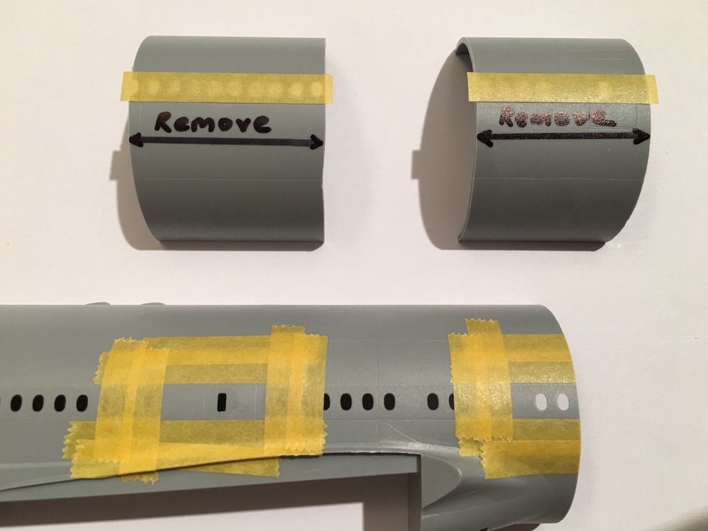

The next photos are of the right fuselage part, everything was shortened to the correct size and ideally matches its left counterpart. All I am left now is correcting the window count. On the center fuselage section are the areas to be hollowed out, delimited with Tamiya masking tape, and on the 2 extra fuselage sections are the window patches to be saved, protected again with the tape :
Here the areas have been cut out, the left hole is still not perfectly filed to the definitive shape while the right hole is ready to accept its window patch :
Glued in place, I now have to finish the other hole and glue the 3 sections of the right fuselage part :
