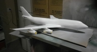

FYI here is a photo of the first coat of white automotive lacquer on one of my current projects. Applied in a fairly thin coat over Tamiya rattle can grey primer. Three coats should do it.
The paint shop I went to makes up paint to any colour you want so I got them to make a can of Boeing Grey (BAC707) and Airbus Grey. Very handy and a lot cheaper than trying to get the Xtracolor enamels these days.
AN 747-300 first coat of white

Hi F-27pax,
Gee....the big ol 743 looks really good so far. Can you give us some details about the kit, I am really looking forward to watching this one.

Postby F-27pax » Tue Apr 22, 2014 1:06 pm
The 747-300 uses most of the old Revell/Advent 747-100 combined with the extended upper deck from a Revell 747-400 kit. The shorter upper deck will go onto the the 747-400 kit to make a Freighter version sometime down the track. I'm aware that there are accuracy problems in both the kits but since I have plans to make a total of eight 747s I'm not inclined to spend a lot of money on getting improved parts such as the JT9Ds, which are not perfect in the kit.
For many years I tried to save money on the white paint I used on models, usually enamel house paint. The result is that they have all yellowed over the years and I'll have to remake or repaint most of them. So what I learned was that saving a few dollars in the quality of paint only leads to trouble later on. The white I bought was a two liter can of 'Spartan Super-cryl advanced acrylic lacquer'. It has a serial number but I've spilled paint over it and can't read it. You will also need a tin of good quality thinner, there's no point in buying cheap stuff if you want a good finish. That should be more than enough to cover a 1/50 707, though will also need lost of metallic finish.

F-27pax wrote:The 747-300 uses most of the old Revell/Advent 747-100 combined with the extended upper deck from a Revell 747-400 kit. The shorter upper deck will go onto the the 747-400 kit to make a Freighter version sometime down the track. I'm aware that there are accuracy problems in both the kits but since I have plans to make a total of eight 747s I'm not inclined to spend a lot of money on getting improved parts such as the JT9Ds, which are not perfect in the kit.
Hi F-27pax,
Thanks for that info. From what I can see you have done a nice job of cross-kitting to achieve a 747-300.
I have a similar project siting of the shelf-of-doom, only mine is planned to be a Qantas 747-338 with the "short-body" Rolls Royce RB211s. On seeing what you have done though I must admit to feeling a little lazy and amateur in my approach. All I did was back-date the wings from a 400 to a 300, ( I was sort of hoping no one would notice that my "300" actually had 400 leading edge fairings :? ). Anyway, on seeing your 300 I will now go away and re-think what I want to do with mine.
As can be seen, I still have much work to do on my 338 including completing the re-shaping of the wing-tip areas.
